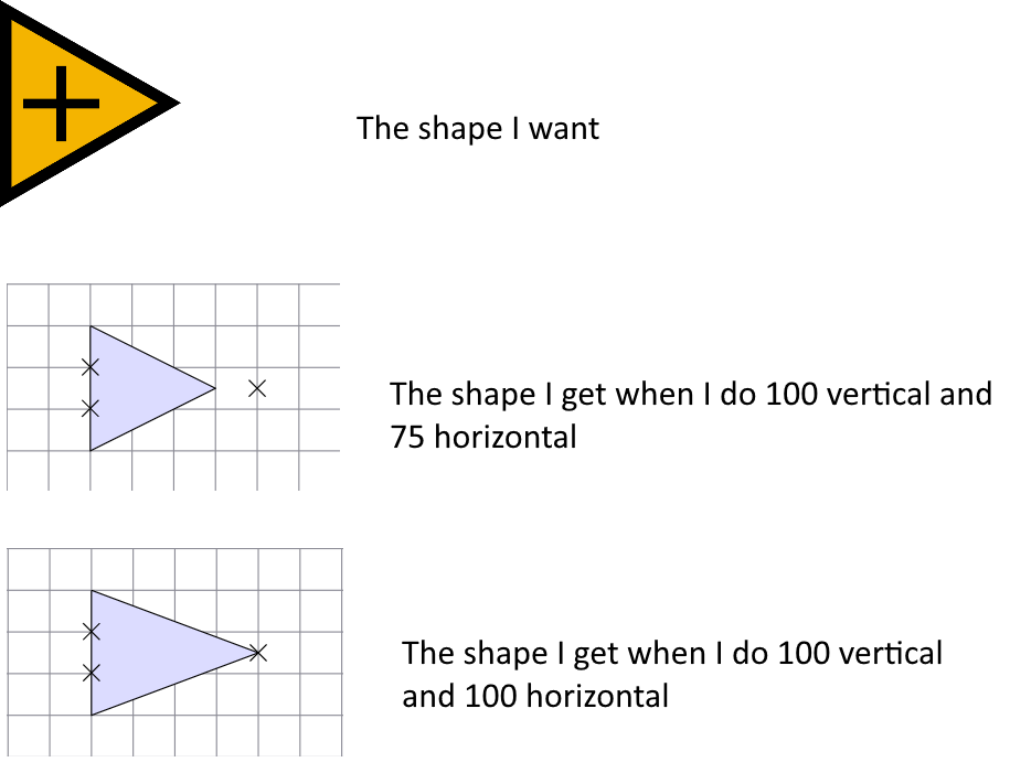

I have a question about designing custom shapes for nodes.
I've attached an image that should appear at the bottom of this post. The image demonstrates that shape I am attempting to achieve, and what I have been able to get so far with my code.

This code creates a triangle that is too elongated in the horizontal direction. If I replace the shape code with this:
Code (C++)
Shape = new Shape(
    new MindFusion.Diagramming.ElementTemplate[]
        new LineTemplate(0, 0, 0, 100),
        new LineTemplate(0, 100, 75, 50),
        new LineTemplate(75, 50, 0, 0)
    FillMode.Winding
Then the triangle is about the right shape, but the AnchorPoint is offset.
What are the units being used here? Why does "100" in the vertical direction equate to 3 grid boxes on the diagram, whereas "100" in the horizontal direction equates to 4 grid boxes on the diagram?
For what it's worth, on my diagram I set GridSizeX and GridSizeY to both be 10, if that is important.

Shape coordinates are specified as percentage of node size, and later mapped to actual node.Bounds, similar to anchor points. So if you want the triangle vertex to match the anchor point, use the first Shape definition where X extends to 100. Then set Bounds to a rectangle with smaller width to prevent the elongation.
E.g. set width = height to make it easier to calculate the coordinates of the embedded plus sign, or set width = sqrt(3) / 2 * height to make it equilateral triangle.
