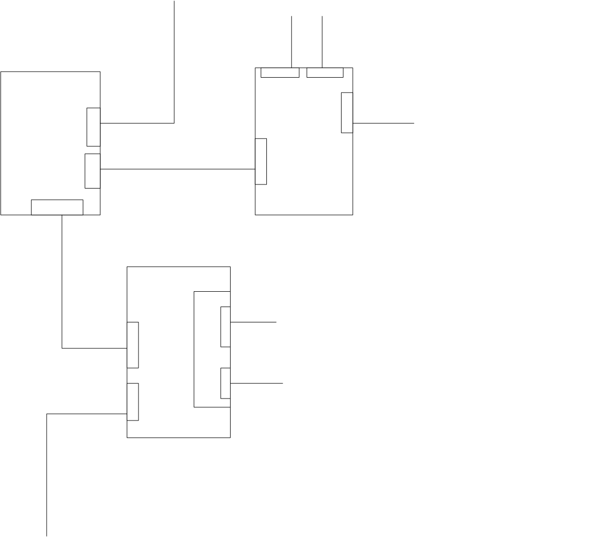

Hey Guys
New to Mindfusion and my first post here.  I am trying to create "connection points" inside containers as per the attached diagram.  My first thought was to simply create rectangular containers inside other containers.  Problem I am running into is how to specify where these connection points get drawn inside the parent.  I don't see any way of setting bounds relative to the parent and I suspect I would be fighting against the layout managers if I tried to do so.  Any suggestions how to accomplish this?  Note containers may have different numbers of children and children may be nested.  I am not committed to any particular layout or entities, just trying to model the diagram as best I can.
Appreciate any help you can provide.
Mel

Hi Mel,
You could try using grouping:
void TestGroups()
	var container = diagram.Factory.CreateShapeNode(
		10, 10, 200, 200, Shapes.Rectangle);
	container.AllowIncomingLinks = false;
	container.AllowOutgoingLinks = false;
	var outChild = diagram.Factory.CreateShapeNode(
		container.Bounds.Right - 20,
		container.Bounds.Top + 20,
		20, 50, Shapes.Rectangle);
	outChild.AllowIncomingLinks = false;
	outChild.AllowOutgoingLinks = true;
	outChild.AttachTo(container,
		GroupAnchorStyles.Top | GroupAnchorStyles.Right);
	outChild.EnabledHandles = AdjustmentHandles.None;
	var inChild = diagram.Factory.CreateShapeNode(
		container.Bounds.Left,
	inChild.AllowIncomingLinks = true;
	inChild.AllowOutgoingLinks = false;
	inChild.AttachTo(container,
		GroupAnchorStyles.Top | GroupAnchorStyles.Left);
	inChild.EnabledHandles = AdjustmentHandles.None;
with a possible drawback you will have to look for the links inside main node's SubordinateGroup -> AttachedNodes -> *Links collections, and get link's node through link.*Node.MasterGroup.MainItem.
Other methods you could try:
- custom-draw the rectangles inside a single ShapeNode; handle link validation events to prevent drawing links from outside the rectangles.
- use several anchor points for each linkable rectangle, with MarkStyle set to Custom; draw a single rectangle for the group of points.
