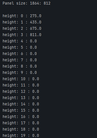

Thank you for these solutions. i come with a different issue now. i wish to save the calendar onScreen and not the one on a headless server as before here. the issue i come across on is that , the calendar uses the JPanel bounds so i cant use calendar bounds.
I know i can use this line to save a full calendar image.
Code (Java)
calendar.createImage(false)
this line gets an image of the whole calendar and its resources, however my goal is to save the image on different pages and for that i could use this line to know where to break page not cut the lane in half.
Code (Java)
double hm = calendar.getElementBounds(CalendarElement.ResourceViewCell,i).getMaxY();
this time it doesnt work because its within JPanel bounds, cant acces all the elements bounds outside the panel
In short, i want to grab the full image generated by the calendar and cut multiple sub images from it, for that i need to know where to cut the lanes correctly. you can notice in the picture, all lanes outside the panel are 0
Cordially
Posts: 3378
Re: Calendar Print
Reply #13 - Apr 10th, 2025 at 4:09pm
Same Schedule can be displayed by multiple Calendars, so maybe you could still create a separate off-screen calendar, but assign the on-screen instance' Schedule to it (also copy the view settings), and then arrange it as in the server scenario to get those heights.
