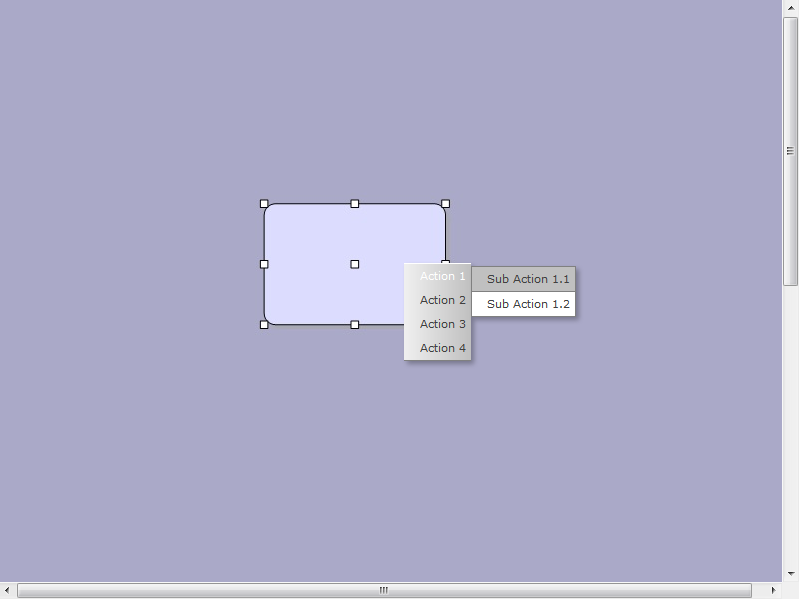

You can check out our Menu control from the ASP.NET Pack release: http://www.mindfusion.eu/ui-webforms-pack.html#menu to use as a context menu. Set the orientation to Vertical and place it in a hidden DIV element. With it you can create something like this:
These are some code snippets that can help you to achieve this

I hope you'll find this helpful.
