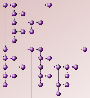

~ TreeLayout has been extended to arrange binary trees as shown below:
To enable this, set TreeLayout.Type = TreeLayoutType.HorizontalVertical.
