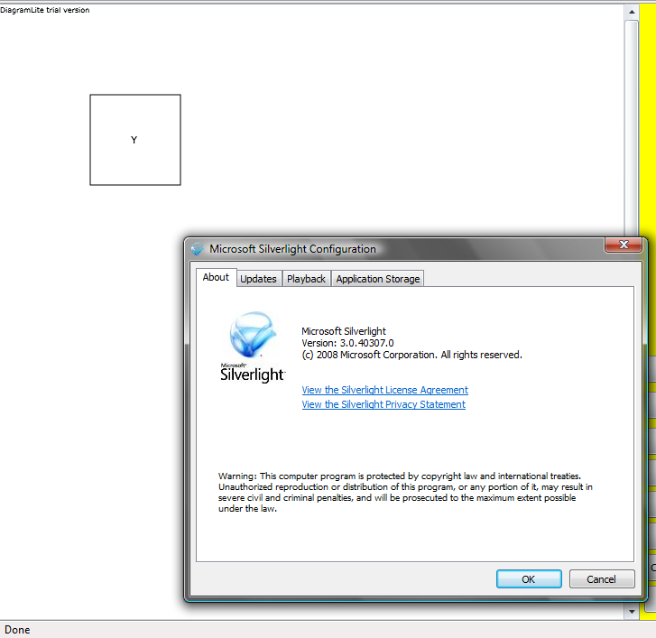

Re: Silverlight 3.0 Support
Reply #9 - Apr 5th, 2009 at 10:51am
This worked in my test:
Could you copy the stack trace here, or best email a project that reproduces the problem to support@mindfusion.eu?
