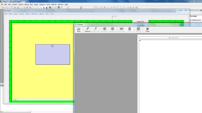

I have a problem with the ScaleToPage print option.
If the diagram is little, it works, but when it is a big diagram, it does not work.
Is there a limit ?
My diagram zipped takes 650kb so I can't sent it to you.
How do I know if the diagram can fits in one page?

Measureunit = 2 (pixel)
top = 0
bottom = 24359
left = 0
right = 157213
Regards
YaBB Moderator
Posts: 3378
Re: ScaleToPage print options
Reply #3 - Apr 26th, 2018 at 8:06am
fcx.MeasureUnit = uPixel
fcx.SetDocSize 0, 0, 157213, 24359
fcx.PrintOptions.ScaleToPage
above fits it on a single page in my test -
ScaleToPage only calculates a current PrintOptions.ScaleFactor value and does not update it automatically later, so maybe check if the diagram size isn't growing at some point after you call the method.

The diagram does not grow.
I saved my graph with tour SaveToFile method.
When I load this file in you run demo application, I have the same problem when i click in Fit Page in the Print preview window.

If I put the A0 format. It works.
I know that the display will be ugly, but the user will see that the printing of this graph in a single page will not be exploitable.
In fact, the problem is that the function does not work for large graphs. The graph remains the same as before fitting the page.
I would like to show him an error message if it's not good.

It actually calculates a ScaleFactor value close to zero for this graph, and since the property is of integer type the setter receives a truncated 0 value and refuses it -
STDMETHODIMP PrintOptions::ScaleToPage()
	put_ScaleFactor(SHORT(100 * ratio));
STDMETHODIMP PrintOptions::put_ScaleFactor(SHORT newVal)
	if (newVal > 0)
The FP value is 0.533210039, which would print a pixel per 200-pixel large box, and that won't show anything legible anyway. I guess you could check if ScaleFactor remains unchanged by ScaleToPage() when the document is very large and show warning to user that it can't fit on a page.
