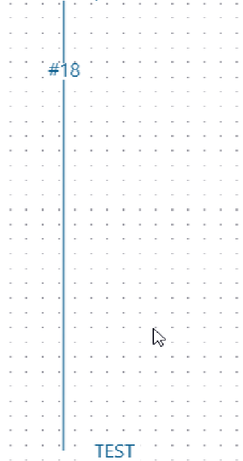

Hello support. I am working with links labels and Link text property as well. It seems like link label bounding box already has some padding added, because the box is larger than link text property even with it's padding set to zero. I've added an attachment where top text item is link text property, and the bottom is link label. Do you have a solution for this?

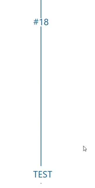

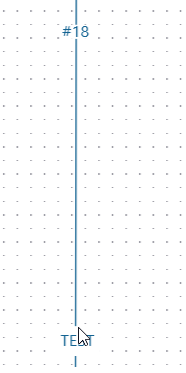

Unfortunately, no. It seems like margin just moves the label. The first picture is label with zero margin (0, 0, 0, 0) and the second is label with margin set to 30 (30, 30, 30, 30).
