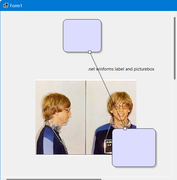

I would like to make the background of DiagramView transparent. Is it possible to achieve this using properties?

If you need overlapped background controls to see through, you will have to override diagram view's drawing -
https://stackoverflow.com/questions/592538/how-to-create-a-transparent-control-w...
http://componentfactory.blogspot.com/2005/06/net2-transparent-controls.html
class DiagramViewEx : DiagramView
    public DiagramViewEx()
        Diagram.BackBrush = new SolidBrush(Color.Transparent);
    void PaintParentBackground(PaintEventArgs e)
        if (Parent != null)
            var rect = new Rectangle(Left, Top, Width, Height);
            e.Graphics.TranslateTransform(-rect.X, -rect.Y);
            try
                using (var pea = new PaintEventArgs(e.Graphics, rect))
                    pea.Graphics.SetClip(rect);
                    InvokePaintBackground(Parent, pea);
                    InvokePaint(Parent, pea);
            finally
                e.Graphics.TranslateTransform(rect.X, rect.Y);
            var behind = new Bitmap(Parent.Width, Parent.Height);
            foreach (Control c in Parent.Controls)
                if (c.Bounds.IntersectsWith(this.Bounds) && c != this)
                    c.DrawToBitmap(behind, c.Bounds);
            e.Graphics.DrawImage(behind, -Left, -Top);
            behind.Dispose();
        else
            e.Graphics.FillRectangle(
                SystemBrushes.Control, ClientRectangle);
    protected override void OnPaint(PaintEventArgs pe)
        PaintParentBackground(pe);
        base.OnPaint(pe);
    protected override void OnMouseMove(MouseEventArgs e)
        base.OnMouseMove(e);
        if (Diagram.Interaction != null)
            Diagram.Invalidate();
            Refresh();
Diagram's back-buffer optimization during interaction does not work well with transparent background, hence the refresh from OnMouseMove override too.

I was able to do it using the method you taught me.
thank you very much.
