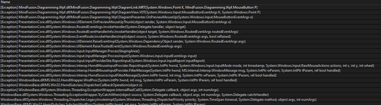

Once the link has been created it is allowed to delete it. The issue is that if later I would hit the left mouse button over the deleted link route the tool crashes due to given mindfusion callstack.

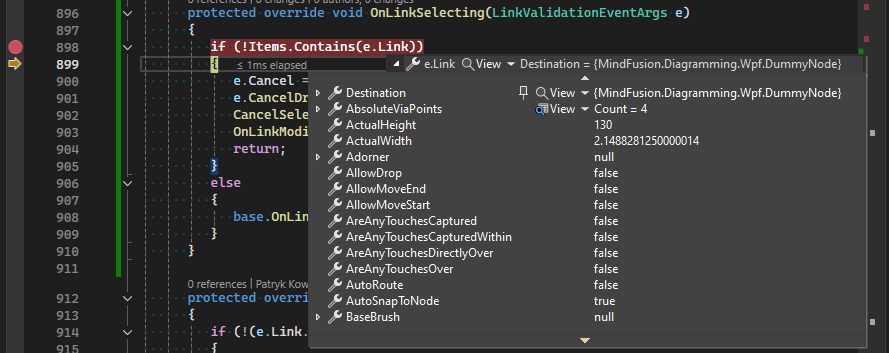

Moreover I override the OnLinkSelecting on my diagram class. It shows that the Items does not contain the link but somehow it is allowed to select it. In result an exception is throwed.

The overriden OnLinkSelecting
