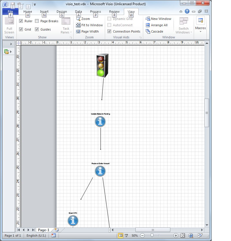

Attached is a diagram XML that the Visio export outputs without links. I would have attached the VSX file, but it was over 250KB.
Note: I don't have Visio installed, so the VSX file is being opened in IE.
AP_WORKFLOWDiagram.txt (Attachment deleted)
Re: Issues with Exorting Large Diagrams
Reply #5 - Jun 3rd, 2013 at 5:58pm
This is what we are seeing in Visio:
How exactly are you opening the file in IE?
