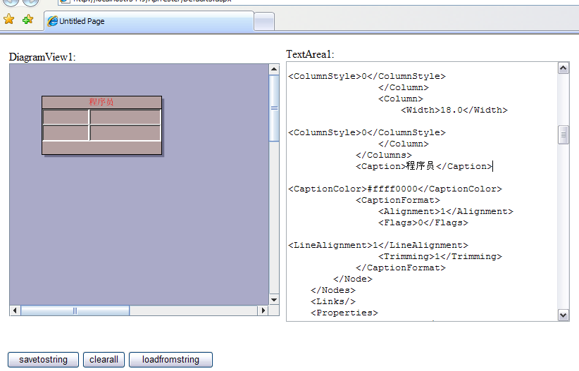

I can see the Chinese characters ok in the text area:

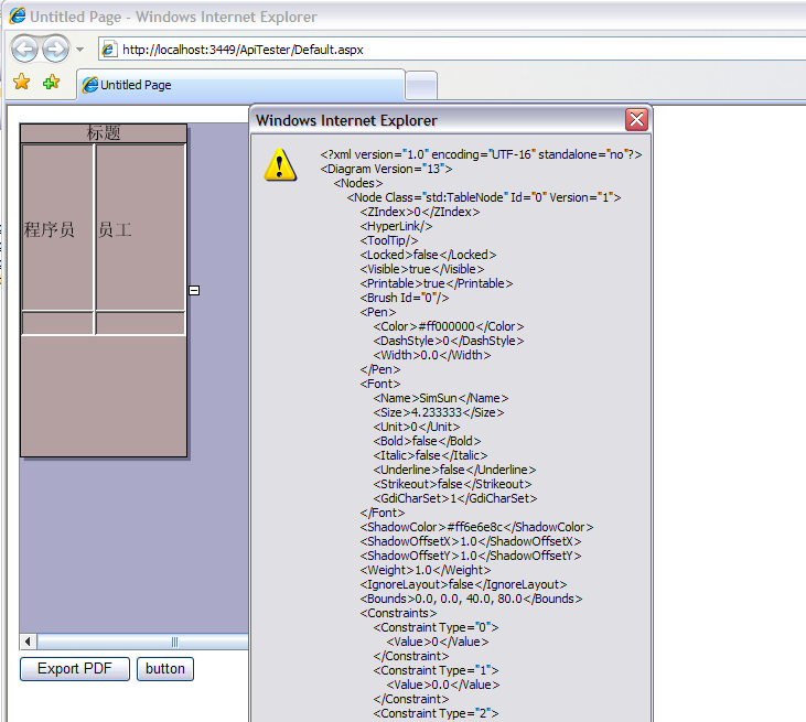

Is the encoding attribute on the first line of the text area set to "UTF-16" after you press the save button? I think we set UTF16 as default encoding in one of the recent releases; if you get a different one, try that with version 3 of the control:

Running on my computer, click the savetostring button to generate the xml data is always utf-8 format, rather than utf-16 format.
I think it was caused by this reason,How can I do to utf-16 format to generate data?

Do the characters appear correctly in the text area if you write something in Chinese there?
