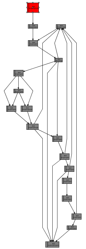

LayeredLayout.setEnforceLinkFlow(false) worked for me, the red node below corresponds to your start node and I think I have drawn exactly the same graph as the one from your image:
Also note that you must call setEnableCustomLayers(true) in order to use custom layers specified via LayoutTraits, and that custom layers can only be used when EnforceLinkFlow is set to false anyway.
