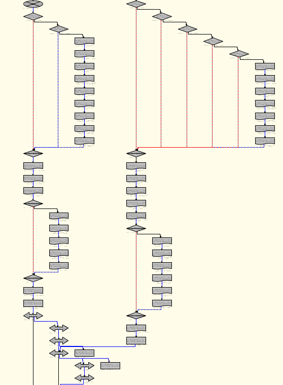

Our diagram contains 492 nodes and 249 links.
We created it with a developped calculated layout.
