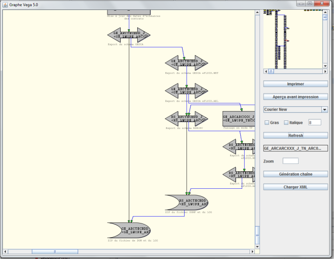

Which of the buttons should reproduce the problem? The Refresh button showed this, the other ones didn't do much and did not cause any exceptions:

Il always reproduce the problem clicking in the Refresh button. I don't understand why you don't.
It's strange. Sometimes when I click on the button, I have the MalformedByteSequenceException in the loadFromString and sometimes the StackOverFlow in the savetostring.
Maybe it is a problem of environment ?
I use Eclipse 3.6 sr2, with java 1.6.0_26.
The fact is that I found the problem in different workstations.
The original problem occurs on a server tomcat with jsp calling my VegaGraphe class and displaying the graph in your Applet.
According to the datas from the database, I have the problem or not.
Have you a debug version of your classes to help us ?
