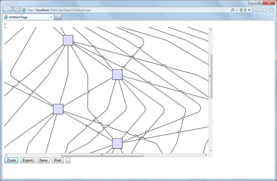

Re: Link between two nodes
Reply #133 - Jul 2nd, 2014 at 7:47am
Quote:
Js file is latest, Please check attached file.
Here's what I'm seeing with following code:
diagram.RoundedLinks = true;
diagram.RoundedLinksRadius = 5;
diagram.LinkCrossings = LinkCrossings.Arcs;
var n = diagram.Nodes;
for (int i = 0; i < 10; i++)
	diagram.Factory.CreateShapeNode(0, 0, 10, 10);
	for (int j = 0; j < i; j++)
		diagram.Factory.CreateDiagramLink(n[j], n[i]);
new LayeredLayout().Arrange(diagram);
If it does not show bridges and rounded bends for you, maybe your browser loads an older diagramming.js from cache. Try clearing the browser cache and run again to verify. Also your script file is a few days older than the one from our last official release, I suppose you are using some pre-release build. Try the official 5.2 version from http://mindfusion.eu/Forum/YaBB.pl?num=1403100114
