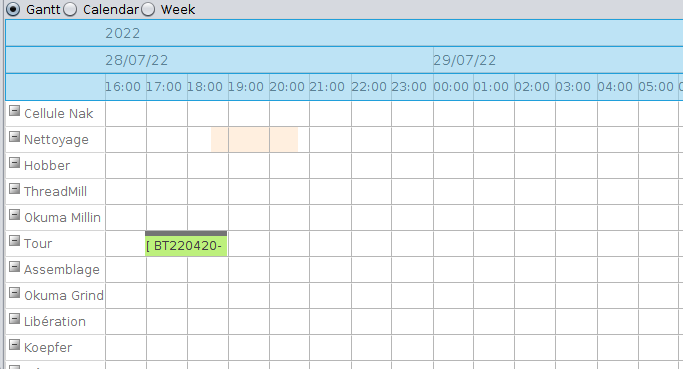

we are testing Scheduling components to see if it will fit into our application.
I'm trying to create ZONES inside the Resource time line (see attach file) to define unavailable time allocations (examples: weekends, close hours like 6pm to 8am we are closed, lunch time, etc.) To do so, I have implement the method draw from the CalendarAdapter.
The draw method get CalendarDrawEvent as a parameter.
I was expecting this parameter to return the start date and end date of each cell to be drawn. It looks that it always returns the same values.
I guess I am not doing the right thing. What is the right way to do it?
(note: I took the Zone sample to develop my code)
See below my calendar implementation. Notice the draw method.

If you want to check if specific hours from bottom timeline are within specific range, use the CustomDrawElements.ResourceViewTimelineCell instead (adding Cell suffix to your code). Then this should report the one-hour intervals from your screenshot:
if (e.getElement() == CustomDrawElements.ResourceViewTimelineCell)
    DateTime cellStart = DateTime.op_Addition(e.getDate(), e.getStartTime());
    DateTime cellEnd = DateTime.op_Addition(e.getDate(), e.getEndTime());
    System.out.println(cellStart);
    System.out.println(cellEnd);

What we are looking for is to have a way to identify in the graph when each resource
may be ready to work. Each resource may have a different schedule (some machines work 24 hours a day, other only 8., some may work 10 hours but with 15 minutes unavailabilities....) I need to be able to draw and identify (to lock these zones too...  cannot allocate  tasks there) unavailable time for each of them.
Is it possible to solve that?

Set CustomDrawElements.ResourceViewCell if you need to draw inside the resource lanes instead of headers. Checking whether current cell intersects occupied time could look like this:
static class TimeRange
	TimeRange(DateTime start, DateTime end)
		this.start = start;
		this.end = end;
	DateTime start;
	DateTime end;
List<TimeRange> occupied = new ArrayList<TimeRange>();
TimeRange occupiedPart(DateTime start, DateTime end)
	for (TimeRange r : occupied)
		if (end.isLessThanOrEqual(r.start))
			continue;
		if (r.end.isLessThanOrEqual(start))
			continue;
		DateTime from = start.isLessThan(r.start) ? r.start : start;
		DateTime to = end.isLessThan(r.end) ? end : r.end;
		return new TimeRange(from, to);
	return null;
Since you are using the range selector which allows zooming, cells could be different than a whole hour, and you might want to fill them only partially:
void calendar_Draw(CalendarDrawEvent e)
    AwtGraphics g = new AwtGraphics(e.getGraphics());
    Brush brush = new SolidBrush(new Color(255, 0, 0, 75));
    if (e.getElement() == CustomDrawElements.ResourceViewCell)
        TimeRange occupied = occupiedPart(cellStart, cellEnd);
        if (occupied != null)
        	double ticksPerPixel =
        		(cellEnd.getTicks() - cellStart.getTicks()) /
        		e.getBounds().getWidth();
        	double startDx = (occupied.start.getTicks() - cellStart.getTicks()) / ticksPerPixel;
        	double endDx = (occupied.end.getTicks() - cellEnd.getTicks()) / ticksPerPixel;
        	Rectangle2D occupiedRect = new Rectangle2D.Double();
        	occupiedRect.setFrameFromDiagonal(
        		e.getBounds().getMinX() + startDx, e.getBounds().getMinY(),
        		e.getBounds().getMaxX() + endDx, e.getBounds().getMaxY());
            g.fillRectangle(brush, occupiedRect);
I guess you will also be considering the e.getResource() value in all this, e.g. you could store a HashMap<Resource, occupied_time_list>, or your own resource model objects could store the list.
Instead of all the custom drawing, you could maybe represent unavailable times as locked items in the schedule, and just style those items.
